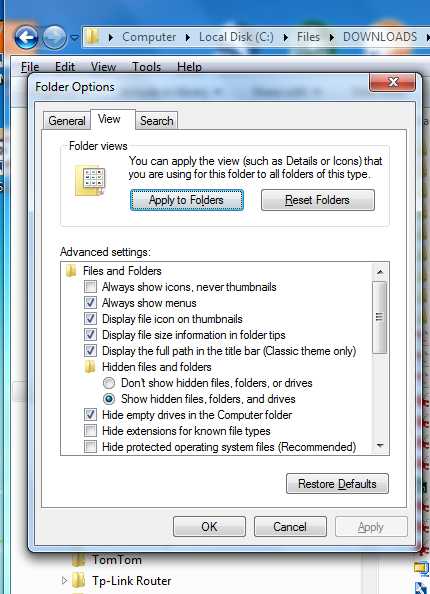

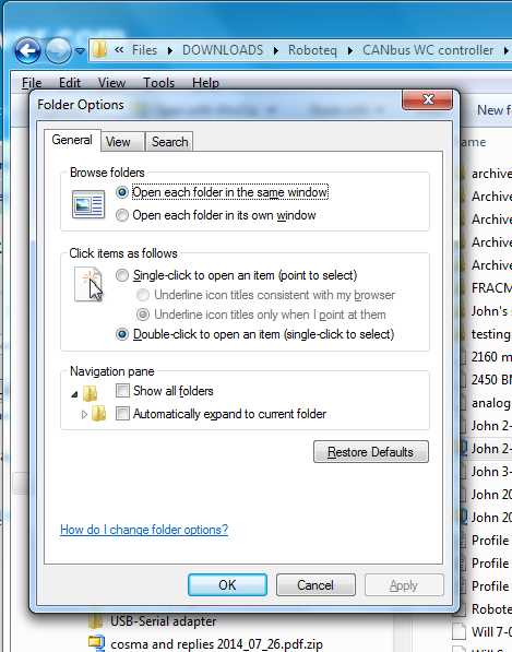

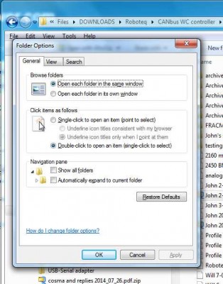

Postby LROBBINS » 02 Apr 2016, 11:22
I don't have Windows 8, but here's how to set what's shown in Windows Explorer in Windows 7 - I assume it's at least similar in Win8/8.1.
(1) Open WindowsExplorer. There may, or may not be, a menu at the top that says: "File Edit View Tools Help". If it's not visible, hold down the alt key and it should appear.
(2) Open the "Tools" item and there'll be a roll-down where the last item says "Folder options". Click that and you'll get a window like this:
(3) Click on the View tab and you'll see a long list of options:
Many of the "Hide" options are set by default. For the moment, the one you want to UNcheck is "Hide extensions for known file types".
(4) At the top of that pane there's a button that says "Apply to folders". If you click that, the next time you open Windows Explorer the view rules you've chosen will be applied to this folder and all sub-folders. If you do this in the root directory of the drive, it will be applied to the whole computer. (BTW, if you start this with the "View" choice instead of "Tools", you can set how your directories and files are display - icons, list, details etc. and that can also be applied to multiple folders. I suggest "details" unless you have a particularly small screen.)
CIao, Lenny
P.S. If Win8 is significantly different, I hope someone will chime in with whatever additional information Expresso needs.
