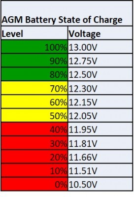

Postby Burgerman » 03 Sep 2020, 20:45
Without a doubt! But they are $$$$$ for another 4A and will not make as much of a difference as you expect.
A big amp charger is great for putting a lot back fast on a very discharged battery. If you discharge a battery deeply 12A is better. So 8mph chairs, 12A pretty much essential. 6mph chairs? Not as important. Because the battery on average doesent get as deeply discharged on a daily basis.
As you charge a battery (A GOOD battery - low impedance, low peukert) it will draw a very high current initially. My ODYSSEY batts when new and healthy draw 80A or so on initial charge. For a few mins. And because they are very low impedance can be 90% charged in 45 mins. But it still takes 12 to 16 hours to FULLY charge after a deep discharge.
Most cheap mobility batts and gels esp dont take that sort of current as they are higher resistance and esp when connected via the chairs long loom and XLR connector. So they may charge at 12A for a while, but it soon drops to a lower figure. This length of time depends on how deeply discharged they are.
If 60% to 100% discharged, it will help them get a better charge on the limited time we have overnight. If only 50% or less discharged, it will barely make any difference.
So yes better. In some cases. And with some batteries. But you will notice a bigger difference by using an anderson connector and a MUCH CHEAPER 8A charger. (you should see the price of 12A mobility chargers!) Because once the charger is at CV the amount of current that flows will be higher. Remember it only flows because theres a few mV difference between the battert volts on charge and the charger volts. And the stock chairs thin loom, and XLR have a fairly high resistance.
So yes it is better. It would be a lot better with decent sized cable and an anderson! And then you are not limited to 12A either. So then a 20 or 30A charger will really add some Ah to a discharged batt part way through the day. But you still need a full 8 to 16 hour charge to make the battery live a long life.
Sunrise also offer a 12A charger (manditory on 8mph chairs as they know that those murder the batteries so are low enough for a bigger charger to help).
Heres an eg.
This is a high powered charger on a fully discharged battery. But thats 30A on a 140Ah battery.
So think of that 30 as 15Amp charger on a 70Ah battery. So just a couple of hours on a fully discharged battery.

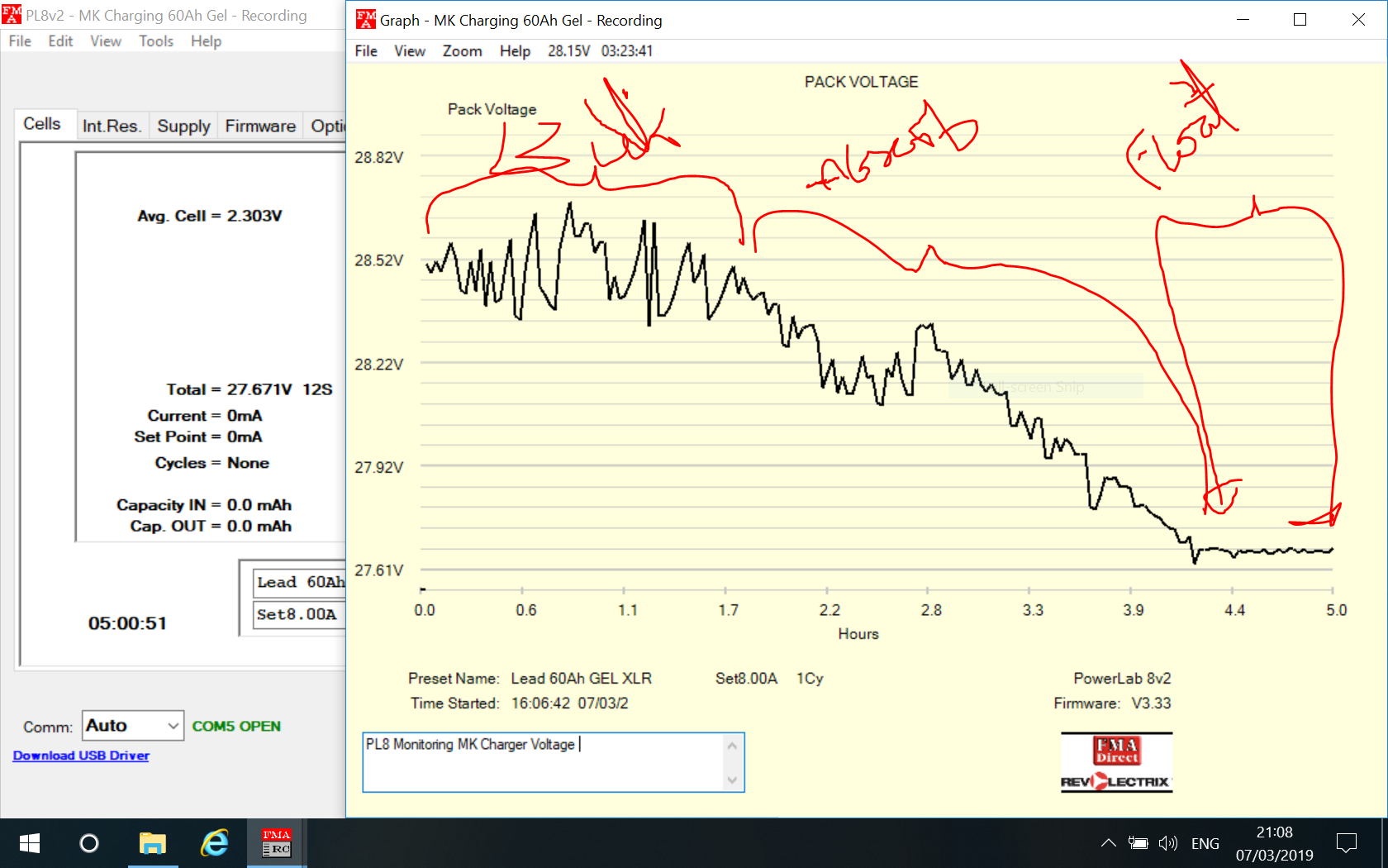

Postby Burgerman » 05 Sep 2020, 18:21
You enter your email, it sends the link.
Its called "technical information". However its about as technical as the website. No useful unfo at all.
They send this link...
http://www.ivra-electronics.nl/admin/mi ... tation.pdf
It claims to charge lithum, AGM and Gel... Which means there has to be some way to switch from one to another. And it claims to charge across a large range of capacity. Which means it must have some way to change termnation current too. If not then its just like every mobility charger...
I doubt they even know. They probably customise the firmware depending on the bulk purchaser wants/needs such as dietz. But most are not that accurate. This is an "invacare" charger...
Logged via the PL8 in monitor mode:
(Note that its so messed up that nobody can figure out what its meant to be doing!)

Postby Burgerman » 05 Sep 2020, 18:31
This is a PL8 charging a battery. This shape curve is what the above graph SHOULD have looked like, what it was meant to be doing. Except for gel, it should never have exceeded 28.2V.
Here below charged BY the PL8, it was set correctly at 14.7V for Odyssey, and to stop charging at 130mA and that takes around 9 hours or so. Note that it does exactly as it says on the tin!

These are correct for SEALED recombinent deep cycle batteries we use. These are after waiting 12H disconnected. And dont reflect the considerable voltage drop loaded and in use... Because nothing can!
The RED part is where your battery meter shows red too! Because the voltage drops under load. When your chair shows red, at 12V, the battery and scooter is done. Finished. Empty. Unless you wait many hours for the peukert to recover some capacity back. AT 12V THE CHAIR IS DEAD. It will not keep going. It will work a light bulb. It wont drive a heavy load like a chair.
Look at HOURS. These are actual usable Ah capacity available from a typical lead battery.
So if you drive a chair at 7mph for 2 hours (14 miles) ... Only THIRTY PERCENT of the lead battery is usable. And you stop. Lead is crap.
This is capacity LOSS due to peukert. The faster you remove power the less there is.
