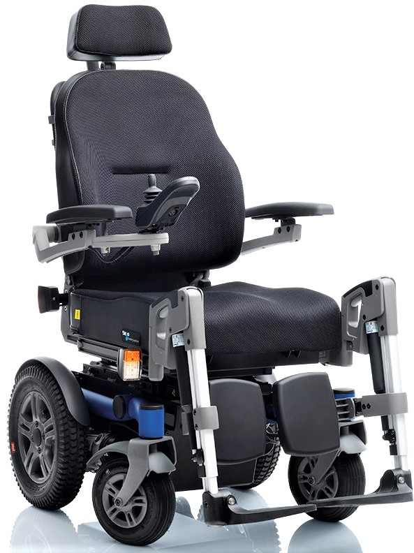

Struggling on good front pics czy
Re: Dietz-Power wheelchairs
Postby Burgerman » 26 Aug 2020, 11:24
That appears to be the same width. So a good width at the front by the look of it. Maybe they use a different front frame depending on footplate choice? Or maybe they are all the wider option?
Either way looks to be a decent choice for a rear drive powerchair. No matter what seating requirements you have. But again, like the salsa, you need the CORRECT options ticked on the order form.
Theres loads but mainly centre footplate (3 options here), 120A PM, the new advanced colour joystick, 9 ot 10 inch casters, the wide - not slim option, grp 24 78Ah batts, 12A charger, single post removable arms, and a decent swingaway (not the one they use) and 4 pole motors - 6mph. Or 8 if you really want a chair for skinny people or flat ground, orboth. Because not really enough torque for good control. And then any seating options you need/want.

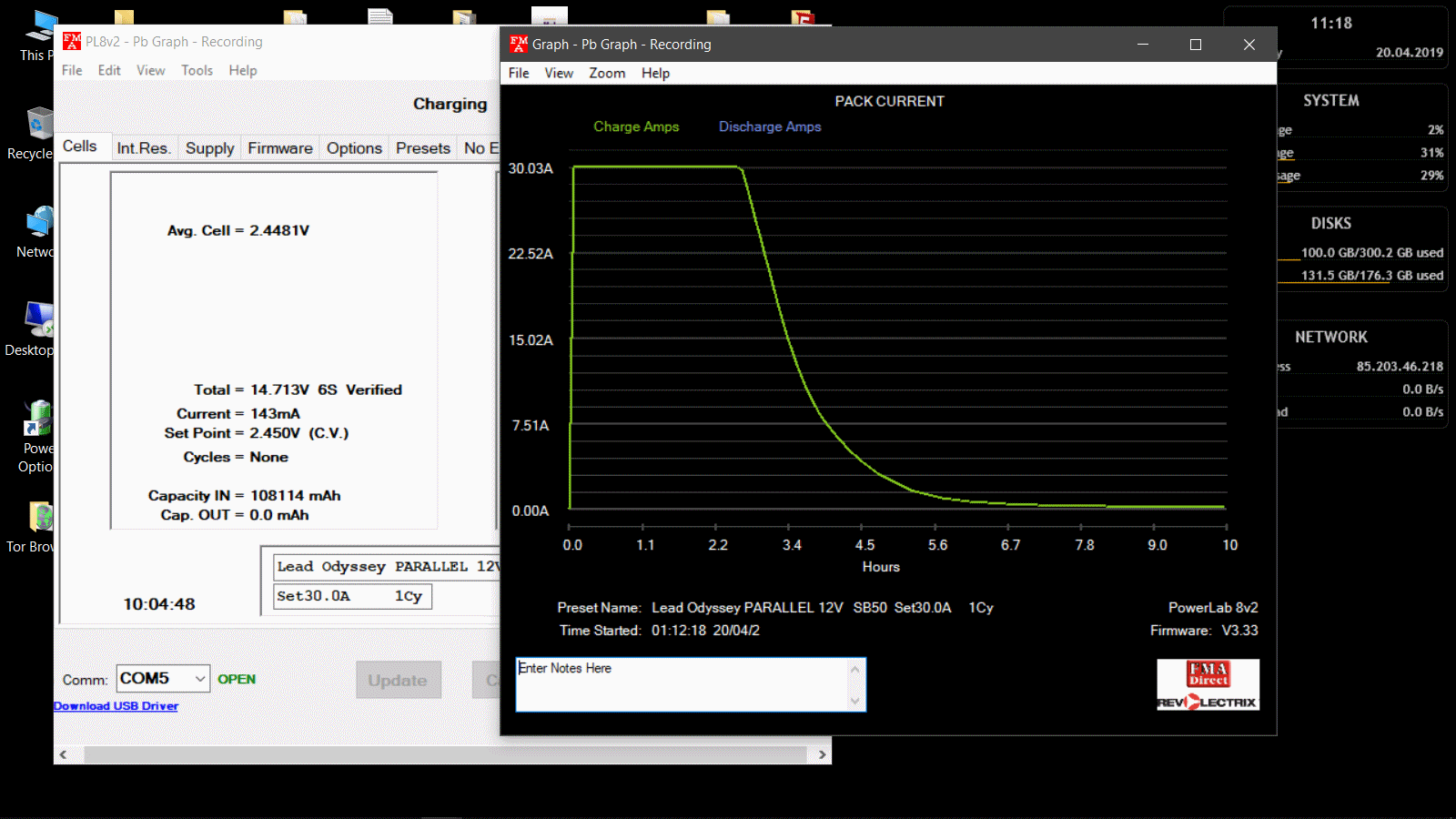

Heres an eg.
This is a high powered charger on a fully discharged battery. But thats 30A on a 140Ah battery.
So think of that 30 as 15Amp charger on a 70Ah battery. So just a couple of hours on a fully discharged battery.

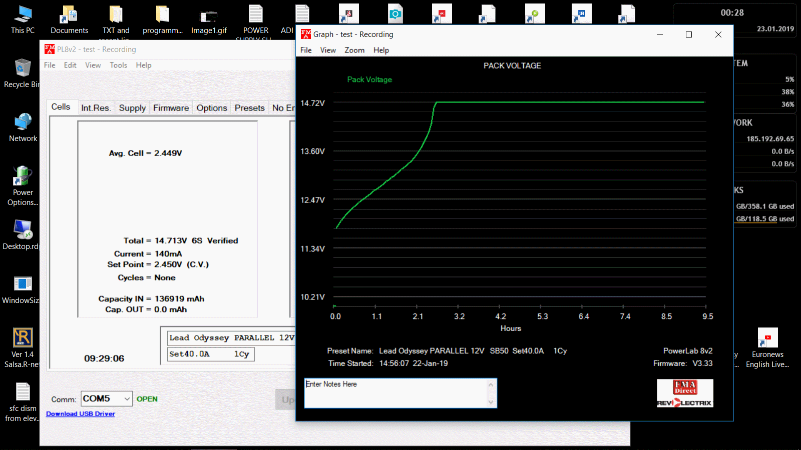

This is a PL8 charging a battery. This shape curve is what the above graph SHOULD have looked like, what it was meant to be doing. Except for gel, it should never have exceeded 28.2V.
Here below charged BY the PL8, it was set correctly at 14.7V for Odyssey, and to stop charging at 130mA and that takes around 9 hours or so. Note that it does exactly as it says on the tin!

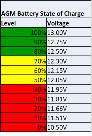

These are correct for SEALED recombinent deep cycle batteries we use. These are after waiting 12H disconnected. And dont reflect the considerable voltage drop loaded and in use... Because nothing can!
The RED part is where your battery meter shows red too! Because the voltage drops under load. When your chair shows red, at 12V, the battery and scooter is done. Finished. Empty. Unless you wait many hours for the peukert to recover some capacity back. AT 12V THE CHAIR IS DEAD. It will not keep going. It will work a light bulb. It wont drive a heavy load like a chair.
