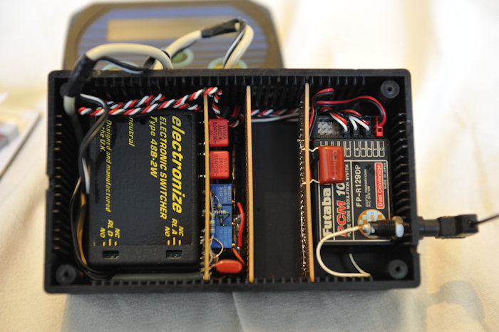

Not really. But I can tell you that later on you will wish you just bought a roboteq!
You should be able to use the receivers output (to a servo) directly, as a voltage swing.
You need a small voltage swing. Although you need a RX that will run on 12v. Its output is pulse width at a specific frequency I think. The signal, and the black wire will give a analog voltage if you add a resistor in series, and a capacitor across the resultant signal.
The MID stick voltage should be half way between the pos and neg supply. This can be fine tuned with say 20k pots, to give correct voltage swing and correct centre voltage. The result will be fed into where the chairs joystick was connected. It works with an omni plus, never tried it with anything else.

Essentially you are looking at an interface issue no matter which way you go. The problem is that the joystick pod communicates with the controller using a proprietary bus protocol (some variant on "CANBUS") so you either need to have an adapter that can take the analog outputs of the RC receiver and convert it to something the controller can understand - which is what that box BM is using at present does. Alternatively you can use a robotics controller, such as the Robotec unit, which can take the RC receiver inputs directly, but then you will need to work on the joystick pod to make it give an analog signal that the Robotec can use... Pick whichever you prefer...

An alternative way to get a voltage swing from a RC reciever is just a single resister and smoothing capacitor.
Or use the insides of a servo, with the feedback pot a couple of resisters as a divider network for centering. The motor wires are then dc voltage out.

Postby Budrowe » 14 Aug 2011, 06:17
The photos are particularly helpful. Lets me see how things are put together.
I'll take anymore if you got them. Thanks
