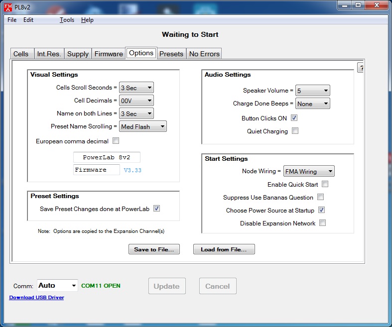

In the PL8 control software, I went to the "Options" tab. I don't want the charger to beep when its done charging while I'm sleeping. So I set Charge Done Beeps to None.
Is that sufficient?
I see a Quiet Charging option right there also. Does enabling that setting mute the charger entirely?
