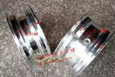

In your case, overall width will be 24.5 inches. Actually a little less.
But these make it 1.75 inches wider each side.
Posts: 69921
Postby shirley_hkg » 05 Feb 2018, 03:35
What tyre are there if we choose 2.5" rims ?
How much narrower then ? goodpost givebeer

Theres no tyre that is the same diameter. Powerchairs come with 1.75 to 2.5 wide rims. A 3.50 x 8 fits correctly on a 2.5 rim, but looks tall and thin in comparison.

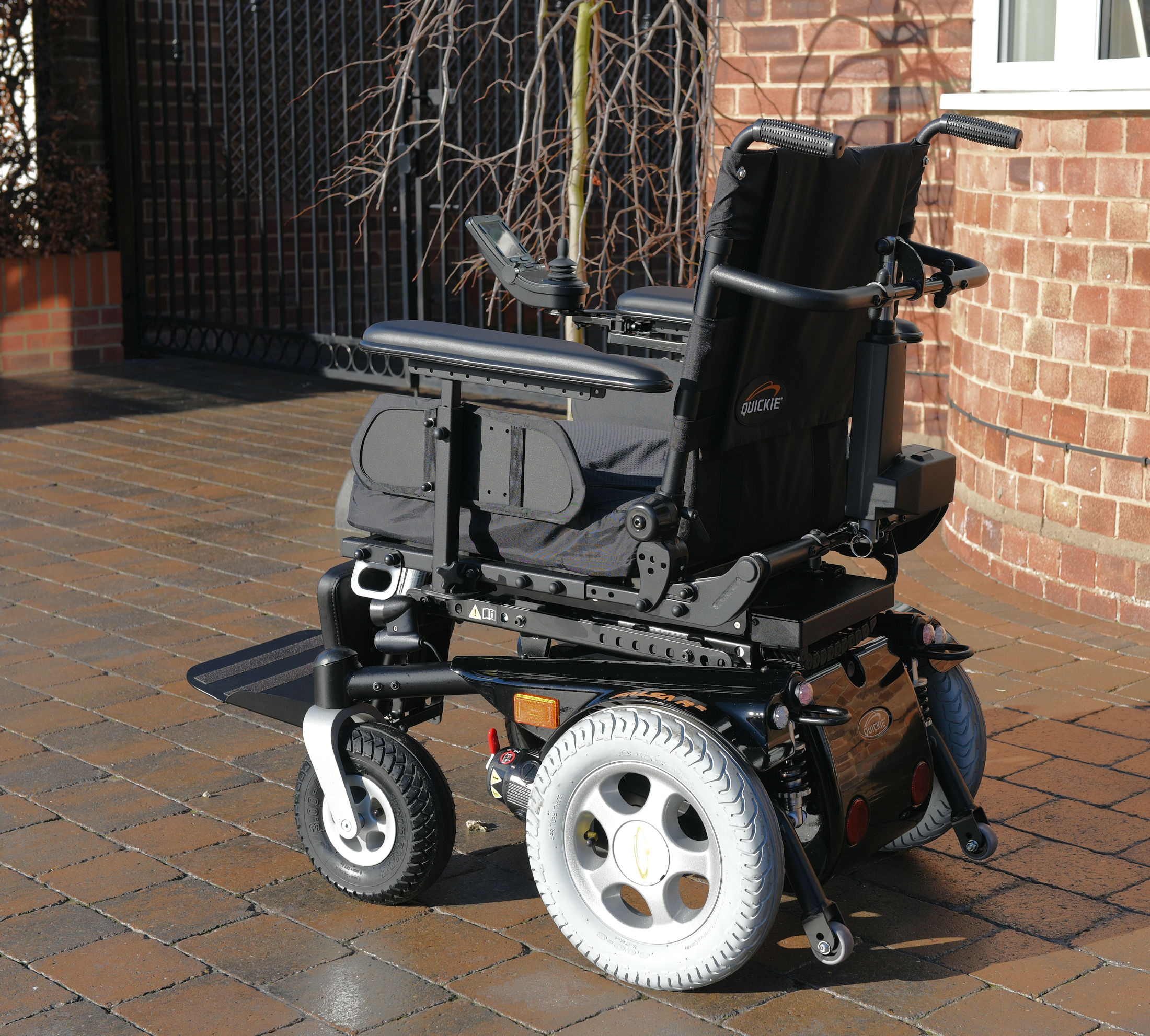

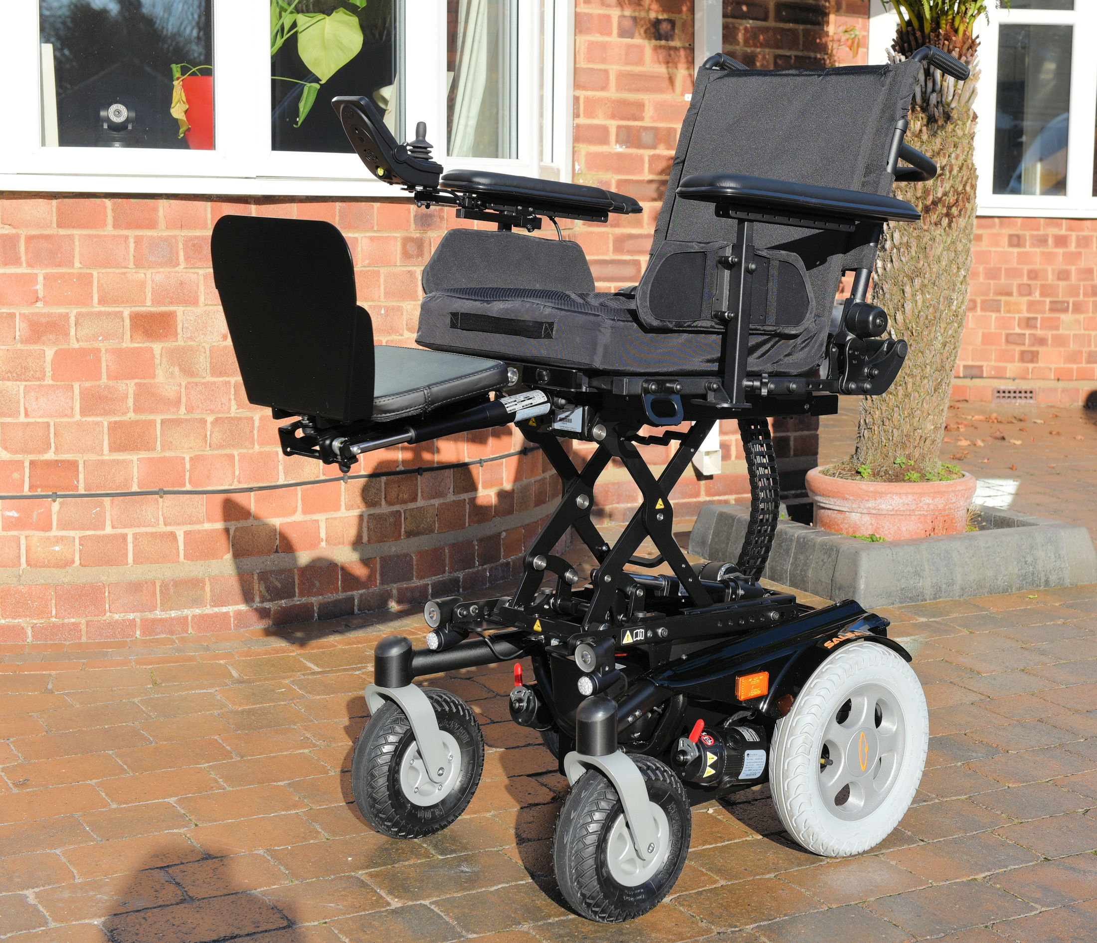

Right, getting up for a few hours today. So a quick pic or two. This is with everything done except
- rear wheels and tyres.
-Jay3 seat back.
Those are still to be done. As soon as the parts come.
Posts: 69921
