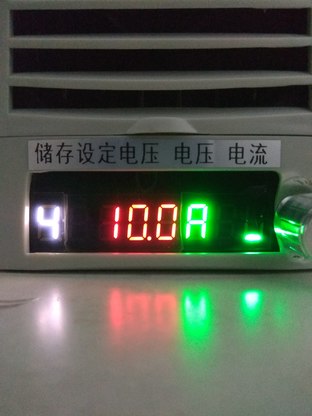

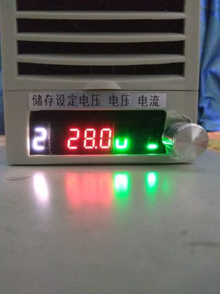

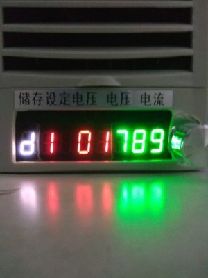

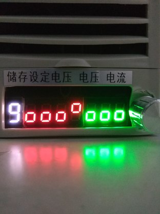

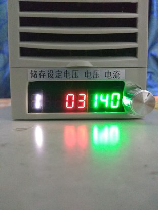

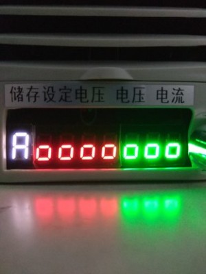

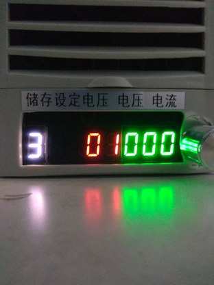

The following are the screen shots.

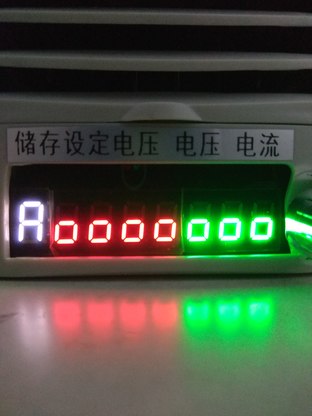

Postby Furio » 22 Jun 2018, 17:29
More.

Postby Furio » 22 Jun 2018, 17:31
Last.Not in order.

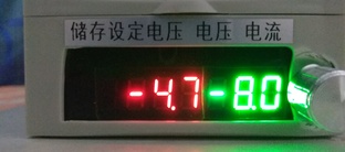

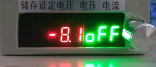

Postby Furio » 22 Jun 2018, 17:46
In OFF position the display shows: -8.1 oFF
In ON position it is: -4.7 -8.0
Now roCP does not appear on display.

Postby Furio » 23 Jun 2018, 05:55
Menu 8 V and A was at 1.0 . :oops: I moved it up to 1.5 saved,and tested.No change in out put voltage and display. So then increased to 2.0, and then to 3.0 but to no avail. The output voltage remains the same; also the display. :cussing
Another thing I left mentioning yesterday, while tinkering with the settings(only from the panel), the fans revved up suddenly and the left side (side with the sticker) was quite hot without any load connected. :o :roll: Immediately I switched off the charger. And now after the menu 8 increased to 2.0 - 2.5, the left side was slightly warm. :?

Postby Furio » 23 Jun 2018, 09:20
Some other observations:
Menu #2 setting: 19V Menu#8 setting: 0.1V Output Voltage: roVP
Menu #2 setting: 30v Menu#8 setting: 0.1V Output Voltage: 2.4V
Menu #2 setting: 30V Menu#8 setting: 1.5V Output Voltage: 5.0V
Menu #2 setting: 30V Menu#8 setting: 3.0V Output Voltage: 5.0V
Menu #2 setting: 60V Menu#8 setting: 3.0V Output Voltage: 10.5V
I will do the factory reset and see. :worship

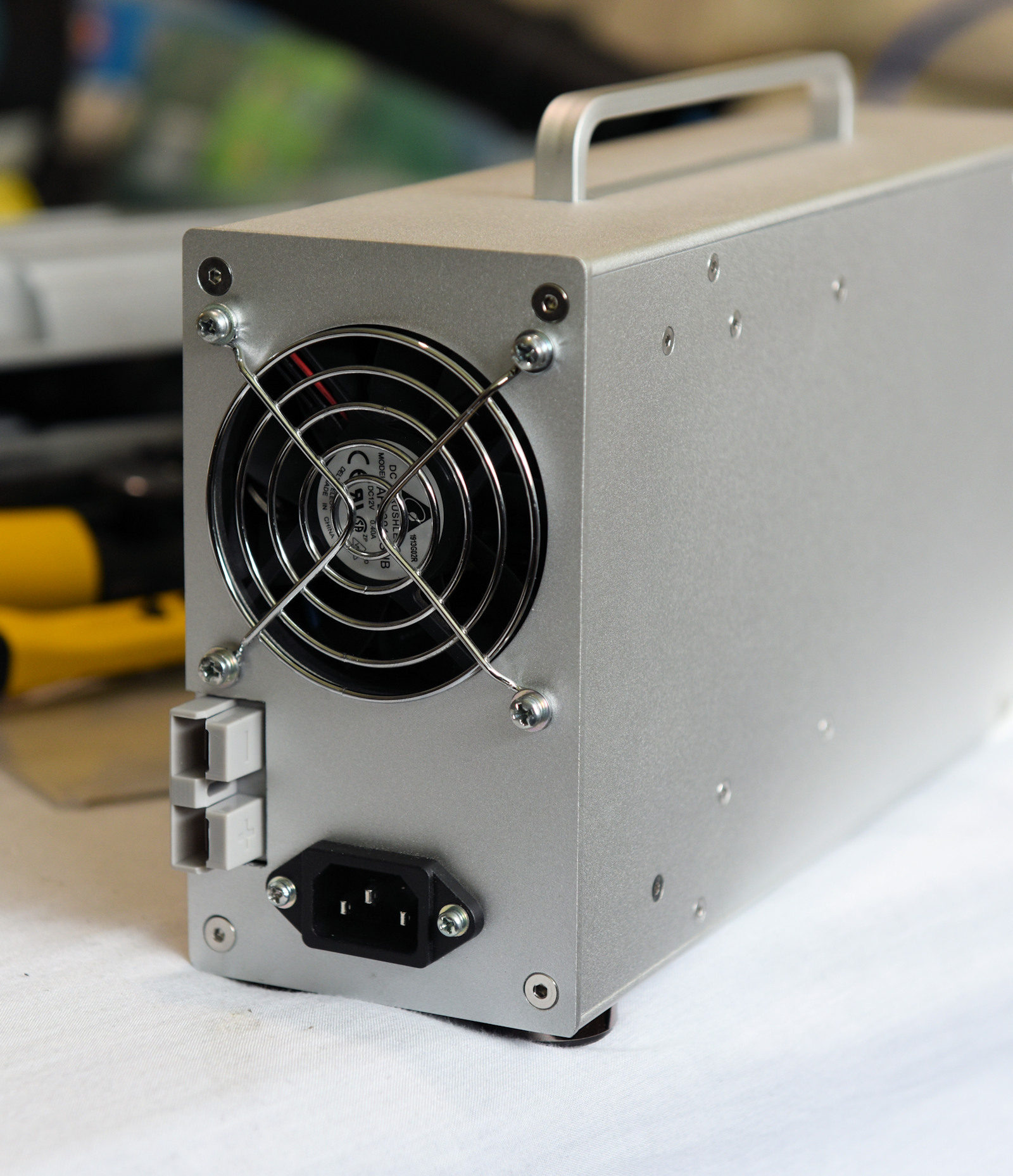

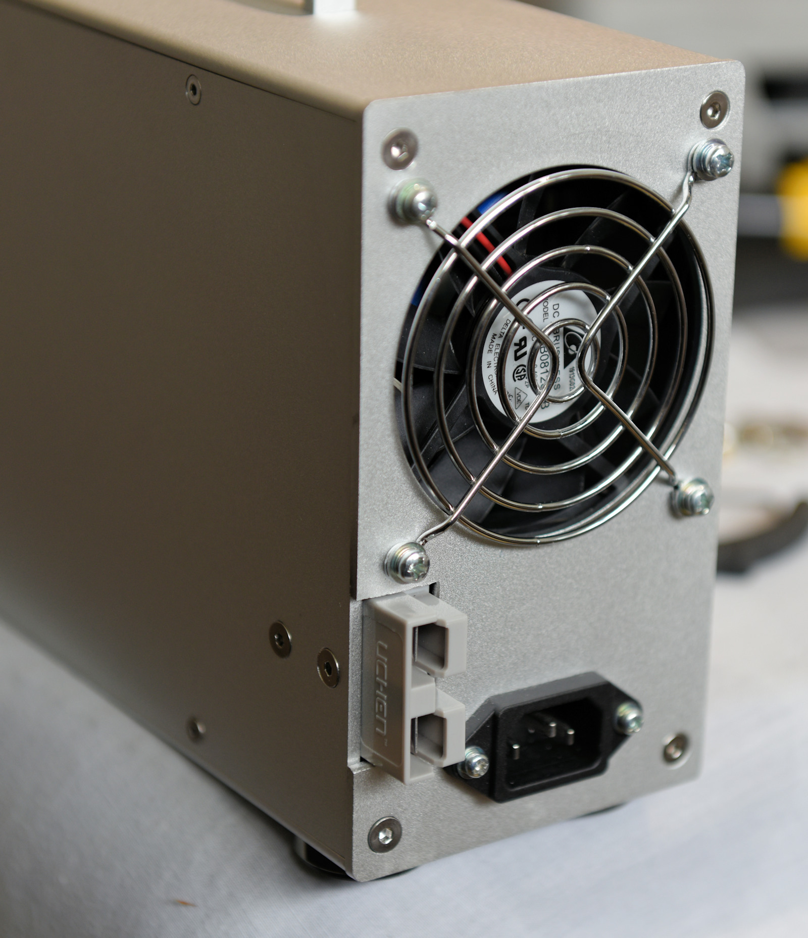

Postby Gnomatic » 23 Jun 2018, 17:04
Finally got around to cutting a notch out of the back plate of the fancy case to allow room for the anderson to be fitted on the back of the charger. Used a small rotary tool and a hacksaw.. Cleaned it up a bit with an old file I had laying around. It looked great, a very clean cut notch.
One problem - the notch was a tad shallow for the anderson to fit. :fencing So I had to take the old file and file away to deepen the notch until the anderson fit, which it now does. Unfortunately now looks pretty jenky, not all nice clean and even like when I finished the initial cut. Oh well, thats just cosmetic. And I won't be looking at the rear of it often. Bit it bothers me at the moment when I see it.
On another note, I'm 99% sure a 25mm thick will not fit in the front of the fancy case. There is plenty of room for a 25mm thick fan in the rear of the case however. I'll be adding that. Also replaced that thick mesh on the front of the case with a chunk of speaker grill. The holes are too big for it act much as a dust filter, but it will keep bigger particles out and allows air to actually flow.
Posts: 2123
Postby Burgerman » 23 Jun 2018, 17:16
And allow sound out. That horidly restrictive stuff it came with was likely used to quieten it. But better to use a quiet fan. Or even a stopped fan since the air flows well with just the rear one especially if you fit a thicker one without that grill. Remember that the two heat sinks are now firmly bolted to the 3mm allow case sides. So the case becomes a heat sink too. If you add two bits of that grey packing polyurethane foam 25mm x 25mm x 90mm to the case top and bottom, you also force the all the air to flow through the heat sink fins.
P.S. I measured two andersons plugged together, and added .5mm to it both ways. And scribed it onto the metal before cutting. I have done this before... And have done as you did in the past. :cussing
download/file.php?id=8333&mode=view
download/file.php?id=8334&mode=view
Posts: 70499
Postby Furio » 24 Jun 2018, 08:44
Well, it is not as expected. The charger refuses to enter auto calibration mode. banghead :cussing
The output voltage can be adjusted as desired but :argument The moment an ammeter is connected,with menu#4 set at 9A, the voltage sags to zero and current at 2.5A. So banghead banghead
Am I looking at a hardware...........? hanged
After charger reset, the default display is 2.62V, 0.06A
Menu#1 01V 715, Menu#2 80.0V, Menu#3 01 424, Menu#4 9.0A, Menu#5,6,7 default, Menu#8 -- --,Menu#9 00^^000,
Menu#A ^^00000, #B , #C ver.3.17
Is menu#2 80.0V OK? czy . ^ means ON.

Posts: 70499

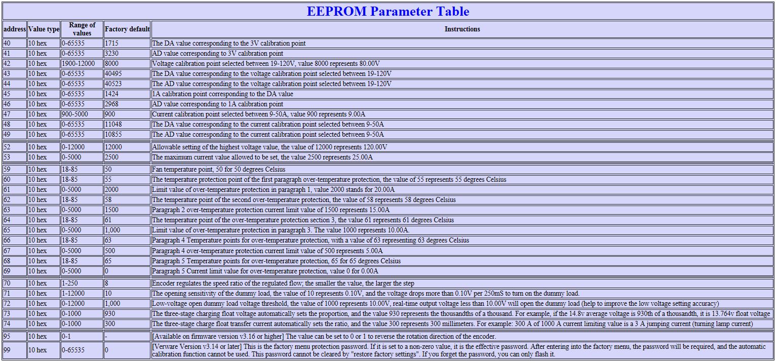

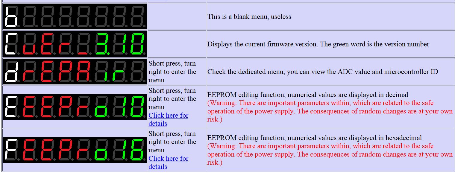

Postby shirley_hkg » 24 Jun 2018, 11:38
The mod guy has locked the menu , that also prevents user to use auto-cal again. Because it will automatically clear everything and back to factory preset.
Click Steve's page and see what menu E is about.
Change the value @ADDRESS 99 back to ZERO , and save it . (look if it is 88 currently).
Turn off PSU . Press and hold 15 sec till you see a white 0 , and you are into aoto-cal again.
Posts: 4569

shirley_hkg wrote:The mod guy has locked the menu , that also prevents user to use auto-cal again. Because it will automatically clear everything and back to factory preset.
A doubt. Both menu E and F have identical parameters. Do we have to change ADDESS 99 in both menus?
