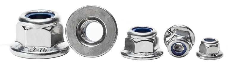

Postby shirley_hkg » 13 Apr 2019, 13:56
Burgerman wrote:M4? Sounds dodgy! Might be OK if that aluminium alloy is hard enough. But it sounds a little small and weak to me.
Helicoils mean you end up with a M6 thread again, but it is steel/stainless steel.
So no room for error then. Stainless is the way to go.
Stud with Loctite , and flange nut for better contact.
Found this flange locknut in one go.
