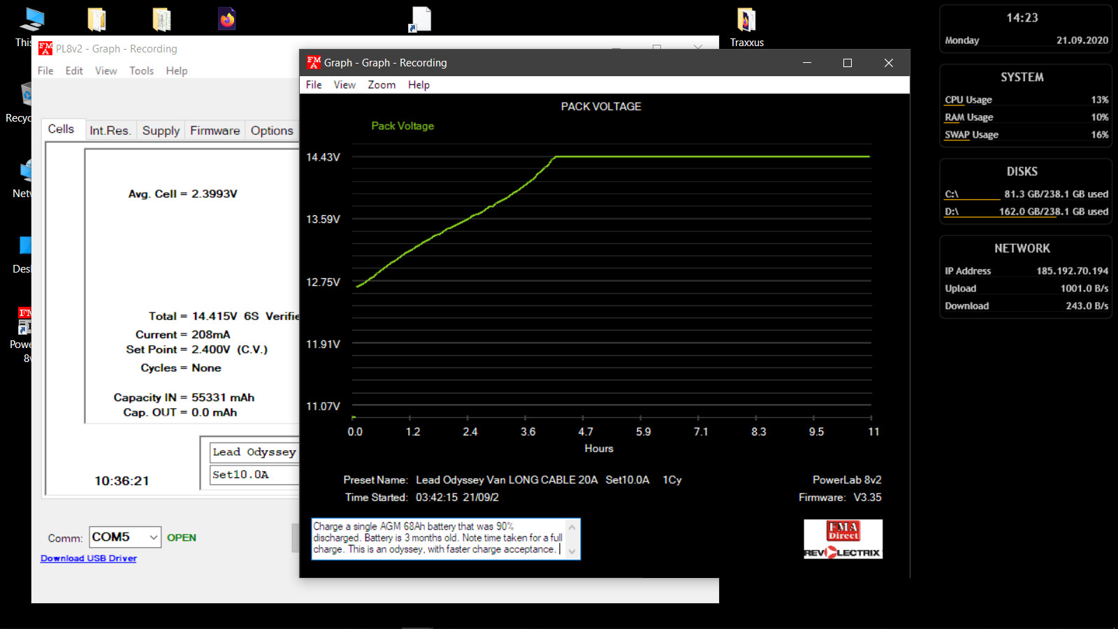

VOLTS v time.
Shows charge volts while charging at 10 Amps. It rises to the CHOSEN 14.4V

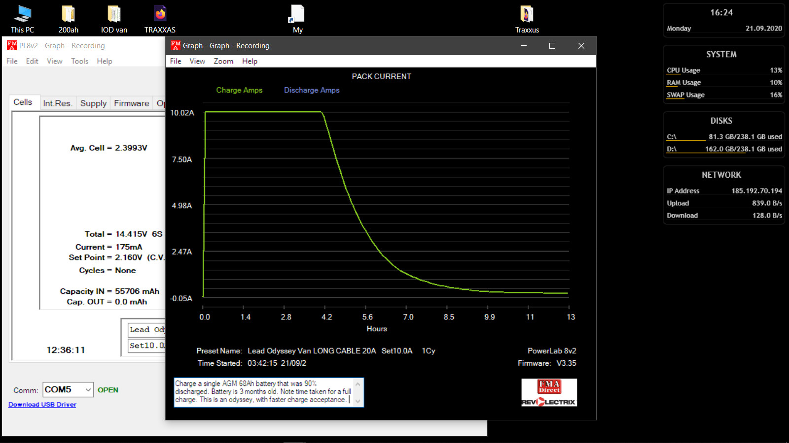

CURRENT. Amps...
Note AMPS. Current v time (12.5 hours now) has dropped to 175mA. So some time still left to go... Still falling. And this is with a 10A charge. The idea that you can fully charge a lead battery overnight is incorrect! These are new batteries. Current still falling. But 12.5H is long enough at his voltage... To FULLY saturate these batteries took a lower voltage (13.6) to lower gassing and recombination which eats power, and another 7 hours or so.

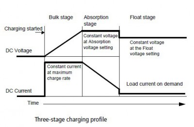

SHOWS A 3 STAGE CHARGE ALGORYTHM. Only the first TWO are needed if done correctly. As with the PL8.
Mobility chargers need 3 because they stop charging at the CV (ABSORPTION) stage way too early to give you a green light...
Same 3 stage solution. Takes around 16 to 20 hours.

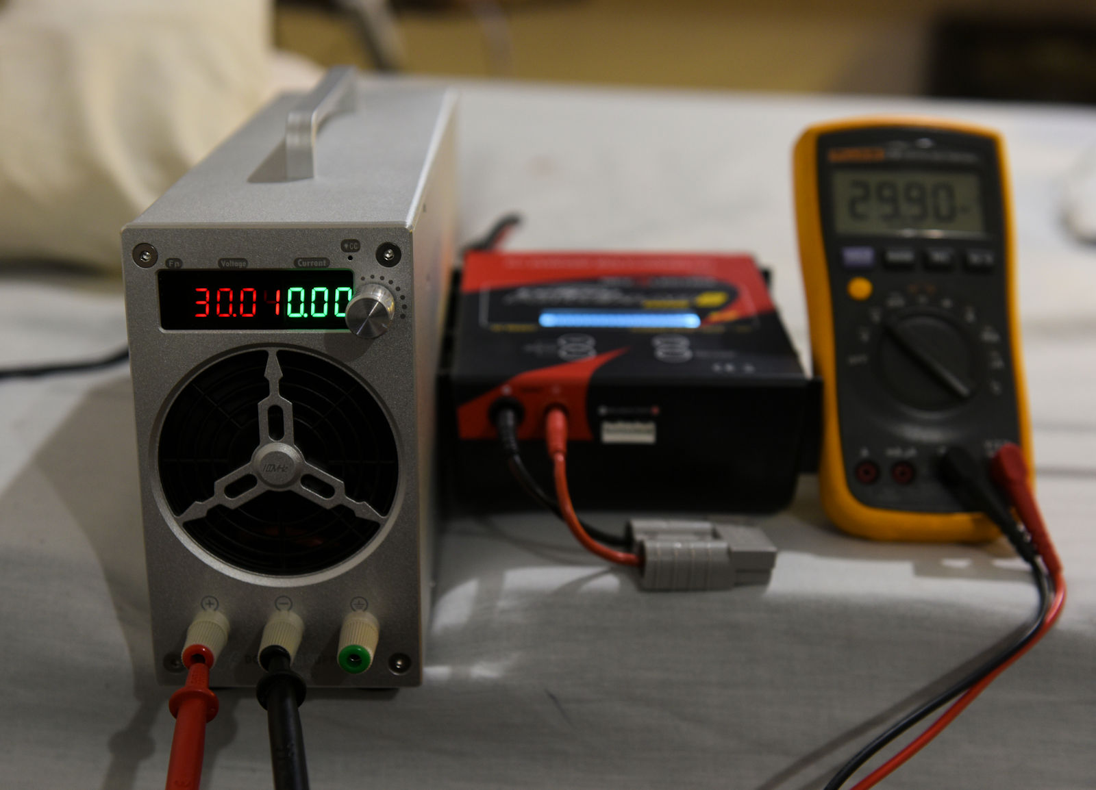

This is why I am using adjustable power supplies and my brain. Or the PL8v2. Or the chinese shirley supplied power supply/3 stage charger. You dont really need a PL8 unless for lithium. The 3 stage power supply charger is great. It is user adjustable as a charger, and also a 50A power supply...
Its on the left here! 0 to 60V and 0 to 50A. 3KW capable. It can be set as a 3 stage charger, or a power supply. To run the PL8 for lithium. Choices... Fast charging... And lithium capable with the PL8.

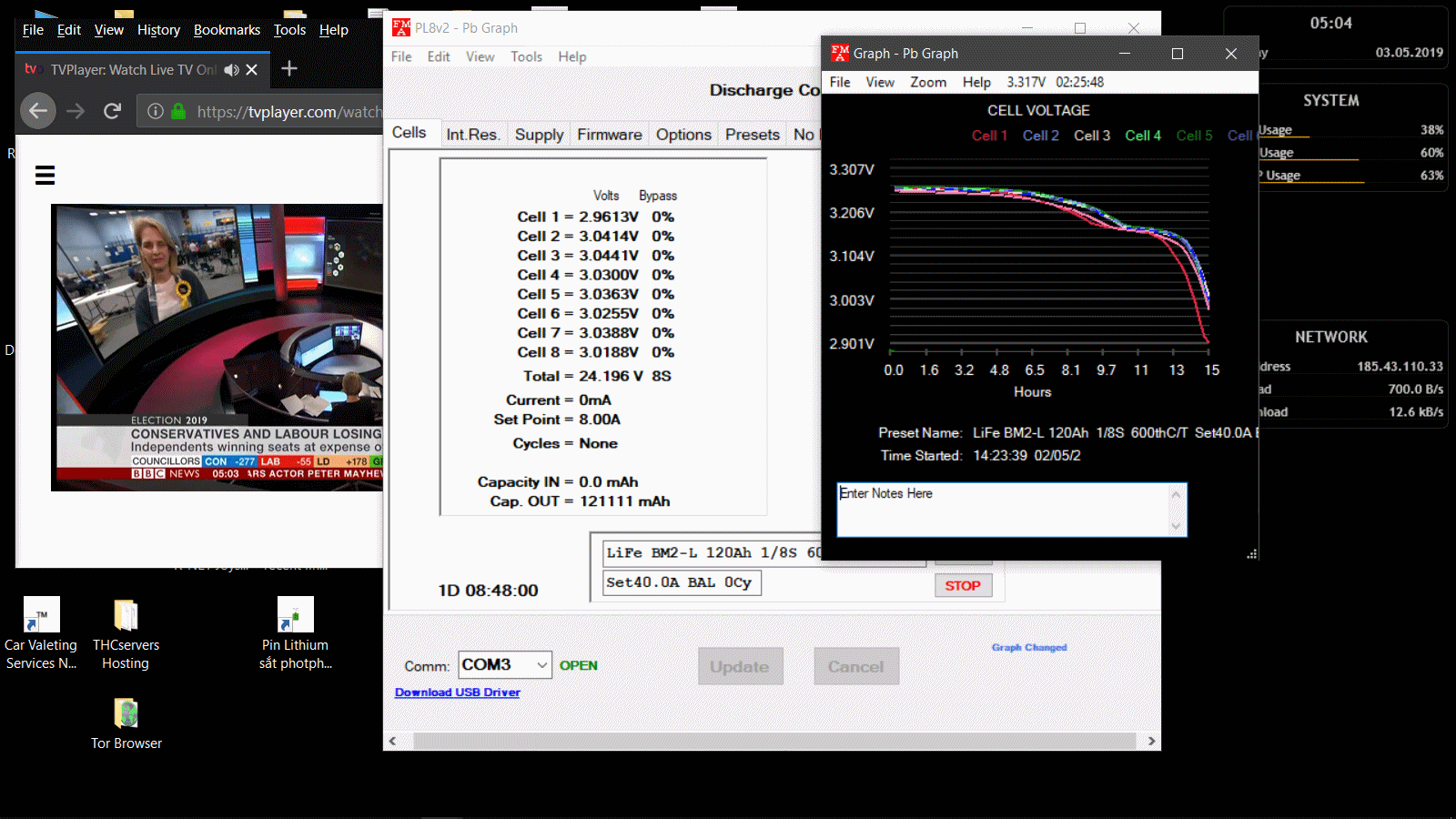

Heres a DISCHARGE test on my BM2 battery. Showing 121Ah removed from its 120Ah battery. The red cell is the first to drop low. This is 6 years old!
