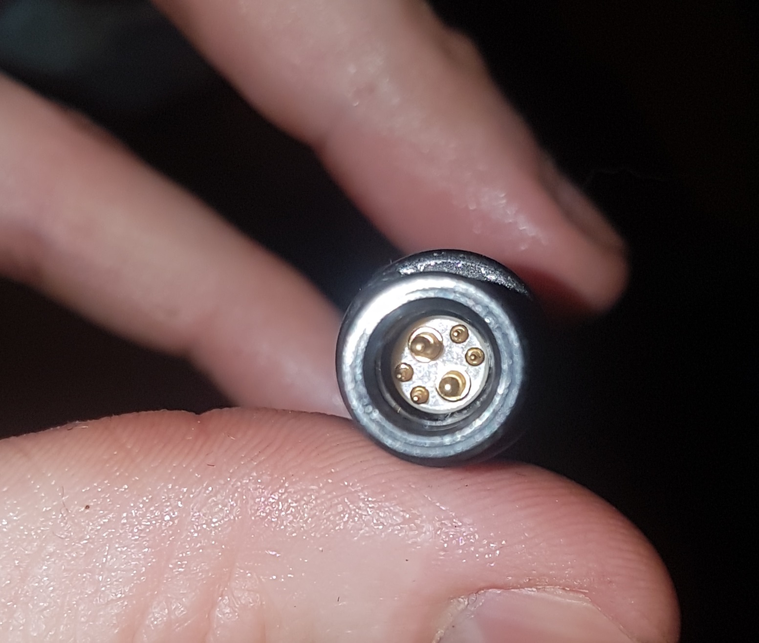

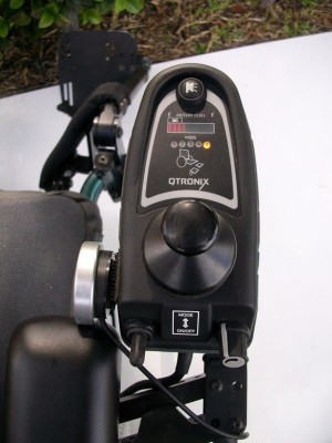

Hello everybody,
I have a quickie 646 se and I would like to know which joystick could i buy compatible to fit on the chair.
The two previous joystick models i had , had no female connector on joystick and both time it is the cable that have broken. So it sucks because the joystick itself works. I drop the joystick often since i use it on my lap switching hands.
Maybe there are joysticks that have a female connector so that next time the cable breaks i could just but a new cable (much cheaper than buying the joystickfusioned with the cable).

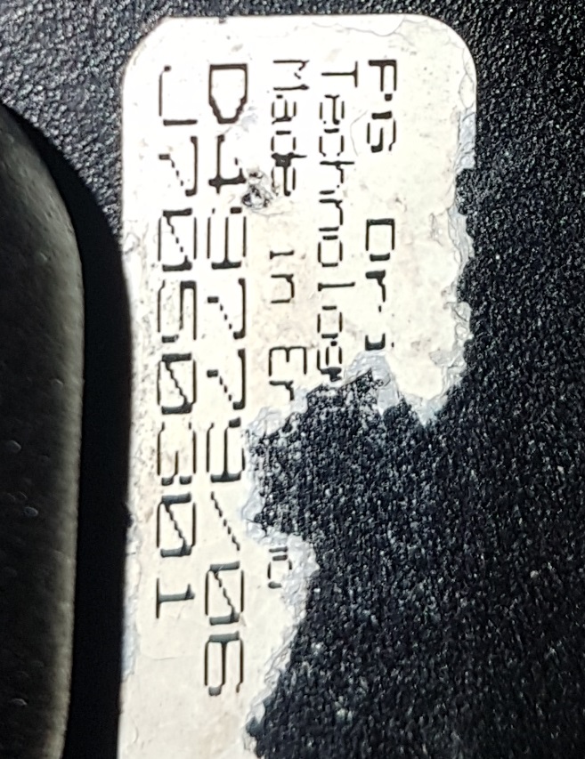

in pict is the identity of the chair because i think we need to be carefull with the computer at the back compatibility.
at the moment what comes out of the computer from the back is a redel connector. I am open to not expensive chinese joysticks (some are less than 100) but the connector they use is different from a redel.
Is there some kind of adapter that can allow the redel to connect to other joystick connector?
Im open to suggestions .

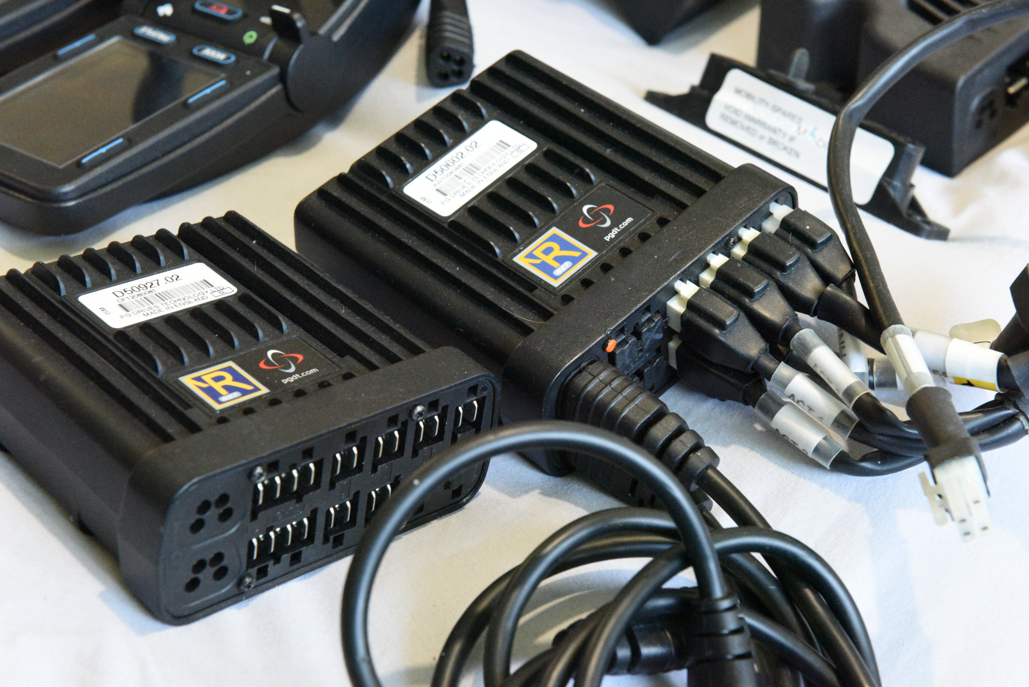

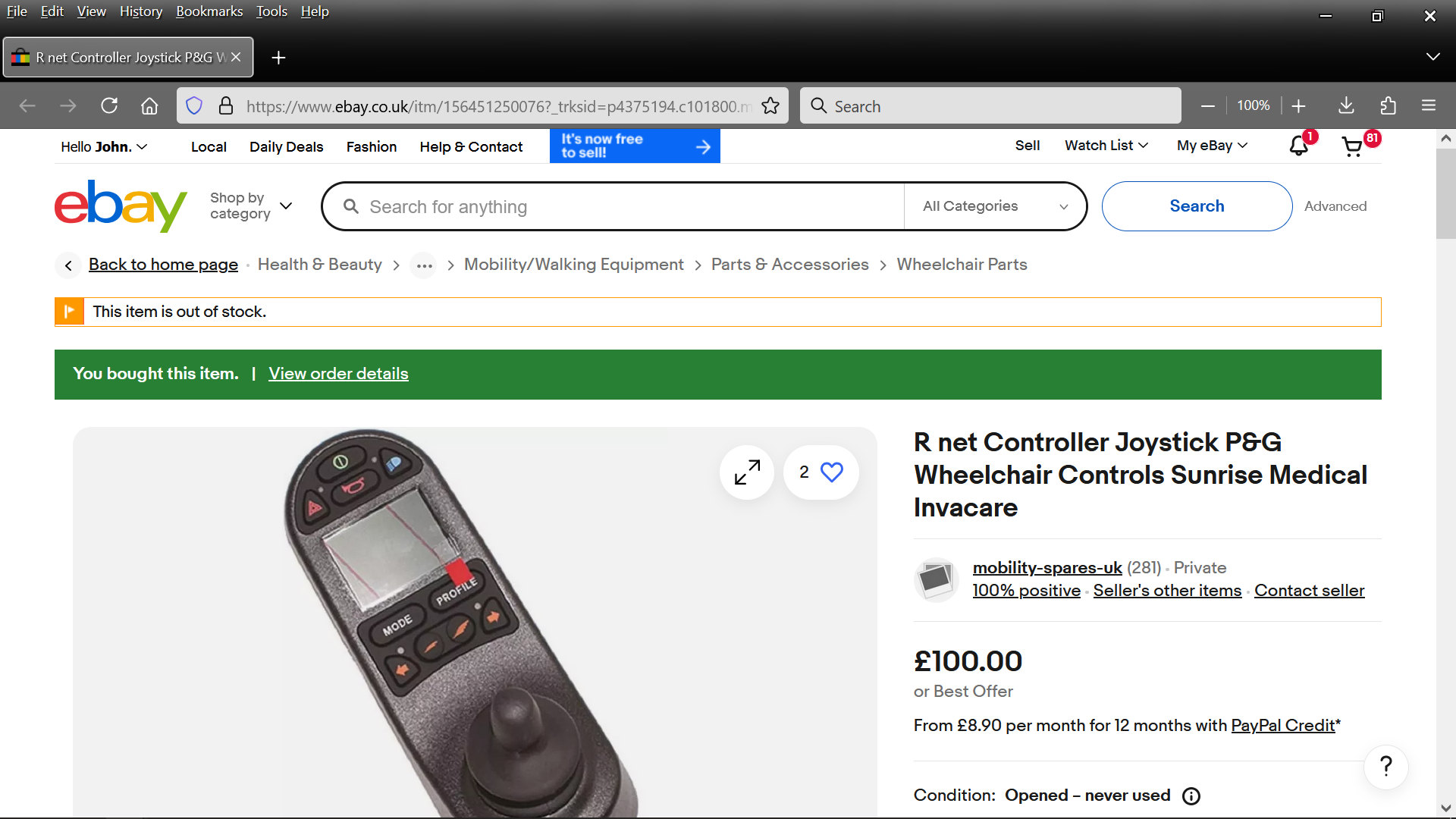

Here is an EXAMPLE of what I just bought on Ebay JUST NOW. While looking because of you... This is more than you need.
I fish ebay for months at a time and only buy pristine or new stuff. CHEAPLY. If the price is too high, wait. I now have 6 sets of R-net complete systems. But when its cheap its good to have spares.
1. £50 (65 US dollars)
For an unmarked 120A R-Net power module. Now I have 4...
A ISM6-L 6 channel seating and lighting module. Now I have 4 of these too!
A bus cable thats worth the £50 alone... I have a box of these.
https://www.ebay.co.uk/itm/276733019965

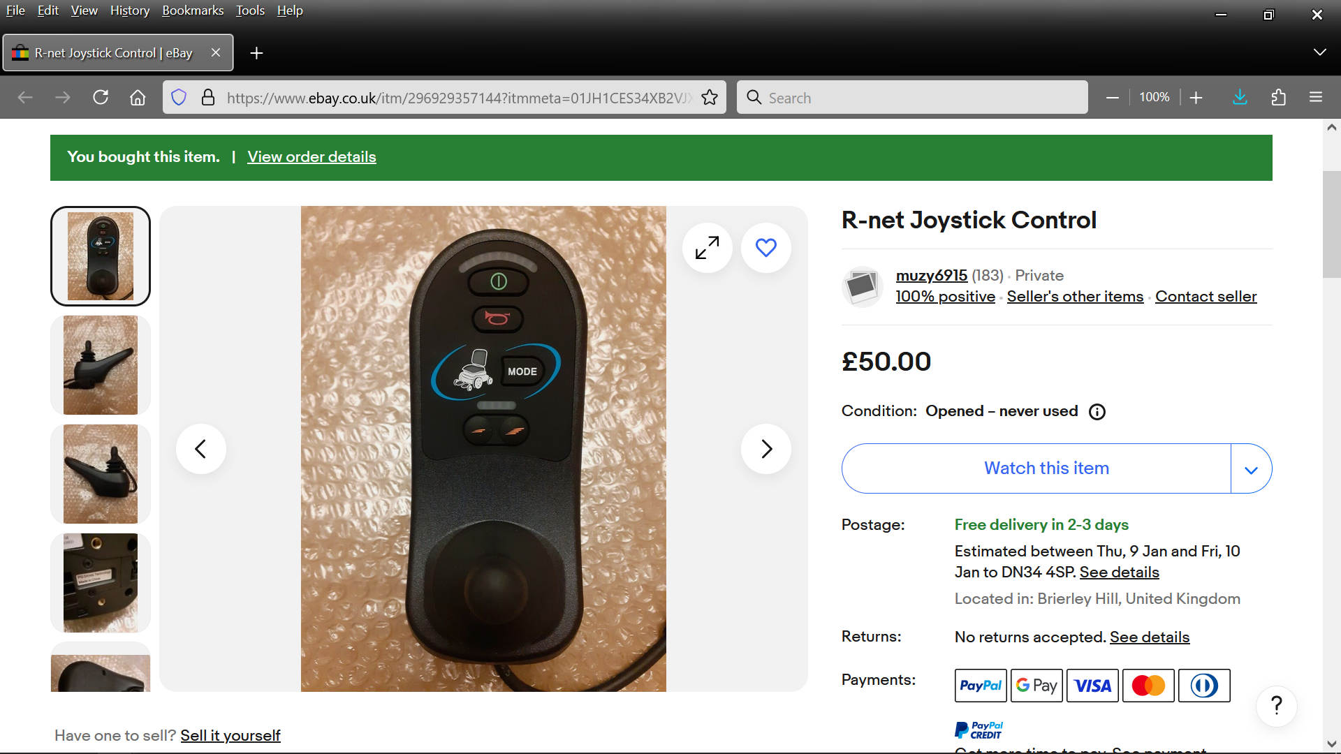

2. A basic LED R-net Joystick BRAND NEW! £50
Brand new i=unused R-net joystick. I have 5 now...
https://www.ebay.co.uk/itm/296929357144
For ONE HUNDRED TOTAL COST, a complete system inc all seating and lighting! All brand new or as good as new. All 4 items, I bought TEN MINUTES AGO!!! Both sellers 100% feedback. Full rehab chair capable system.
Thats everything needed for power drive, powered seating lift, recline, tilt, power footrest angle and length, And lights and one channel left over!

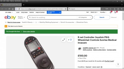

Note, it says I BOUGHT THIS power module, bus cable, and seating and lighting module (all 3) literally 10 mins ago...
Note, it says I BOUGHT THIS JOYSTICK (literally 10 mins ago)

Theres a very scarce redel cable here https://www.ebay.co.uk/itm/126639068319
At the typical crazy price you pay for old no longer made stuff...
Remember that for a tiny bit more I got a 120A R-net power module, a brand new R-net joystick and a seating/lighting module, AND a free bs cable!
Now you see why it doesent make a lot of sense. Your repair is not reliable as it raises many stressed edges and its old and brittle.
Heres a cable and joystick, used 135 uk pounds.
https://www.ebay.co.uk/itm/333751414519

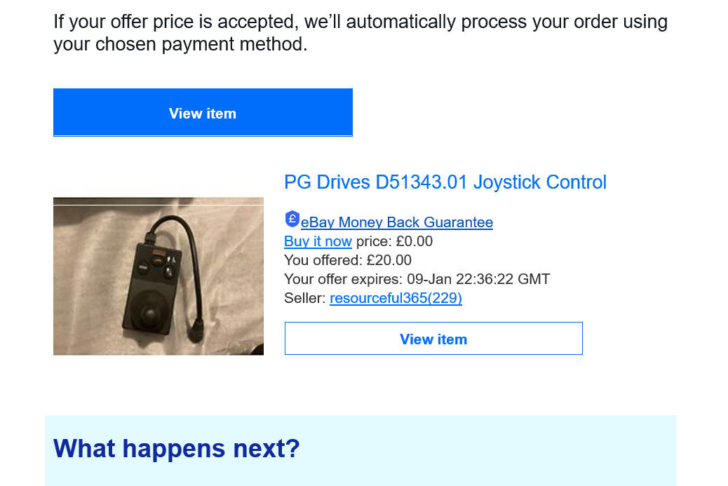

So when one of these appeared yeterday and was NEW for £40 delivered, I offered 20...
And won it super cheap.
Offer
Accepted

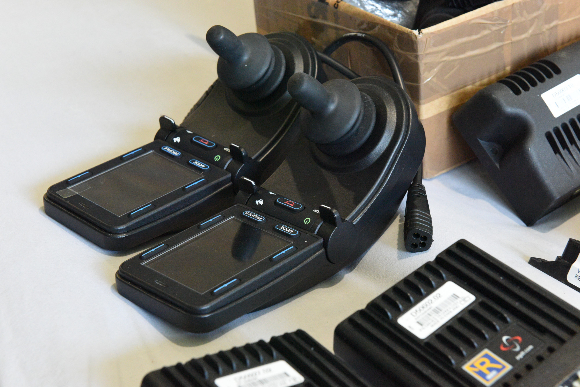

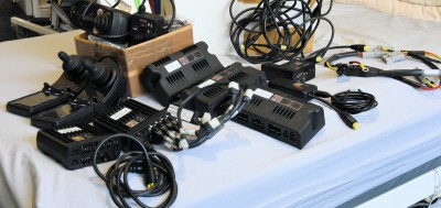

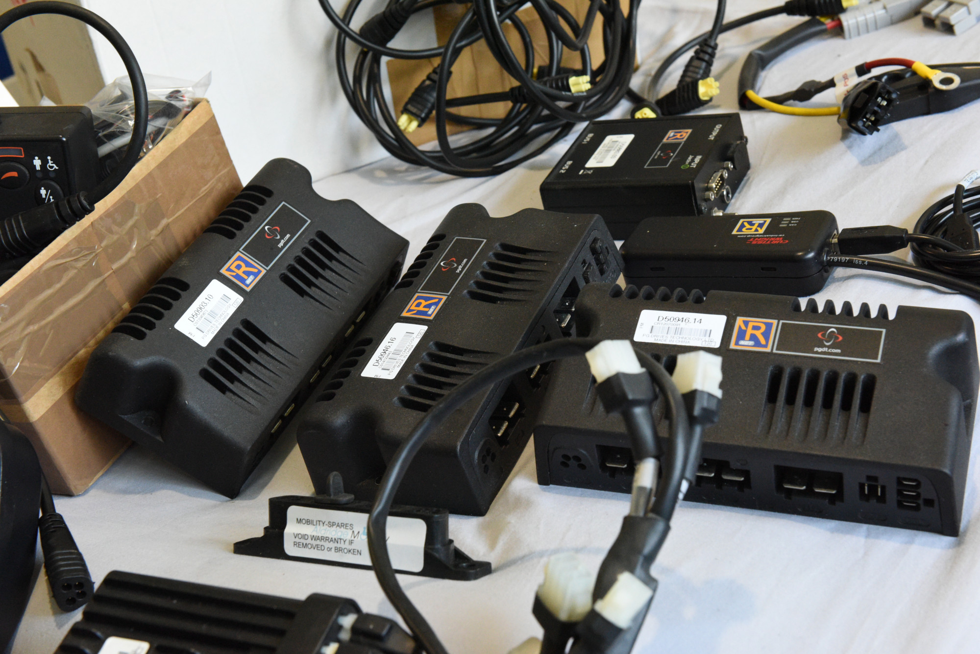

More stuff I already bought silly cheap by learning to "fish" on eBay...
The total price is under £1k for ALL ofthe following combined:
Enough to fully equip 4 complete rehab powerchairs from scratch sat on my shelf!
FOUR of the 120A R-net power modules not new, but they all look it!
THREE of the fancy CJSM2 joysticks. All brand new.
ONE of the CJSM1 joysticks, new.
TWO of the LED joysticks both brand new. One with lights buttons, one without.
FOUR of the ISM6L seating and lighting modules. 2 new, 2 used. Some included full seating looms.
TWO of the multi bus cable blocks.
A huge box of battery loom and bus cables of various lengths all tessted and with 150A fuses. All used. But cleaned/exmined and look new.
An attendant R-net Joystick, just bought below:
An IOM module.
An R-net gyro...
This week alone I paid £50 for brand new R-net LED joystick.
And...
And £50 for a R-net 120A power module complete with another R-net ISM6-L seating module, and a "free" bus cable! :shifty:
Re: How to dertermine wich joystick can fit on my quickie 64

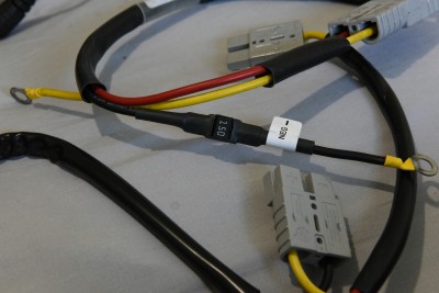

Postby Burgerman » 09 Jan 2025, 12:07
Some of it...

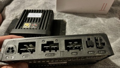

these 4 items all arrived today.
Power module, cable, and seating module all used and from 2017 but look brand new and shows low hours.
Joystick still sealed in original packaging so obviously brand new. It does seating, profiles etc. (Not lights).
Power module and seating/lighting module and cable all tested out as working and now programmed as a spare. So plug and play.
Full system, for a chair with lift, tilt, recline, power foortrests, and a 120A control system. For £100 brand new. Whats not to like! :clap

The person needs part number . so here is a pict of my 2 qtronix stick (at bottom)
PG Drive technology
D49780 /09
J3080156
PG Drive technology
D49779 /06
J7050301
Is there a way to have all the numbers corresponding to the qtronix Joystick?
I imagine there are more than 2 ..
yeshelp
Posts: 382
Joined: 11 Jan 2021, 14:56
Location: canada quebec
Postby Burgerman » 23 Feb 2025, 02:37
No he doesent need a part number.
ANY Qtronix or Pilot plus joystick, and any redel cable will work. Thousands of different numbers!
