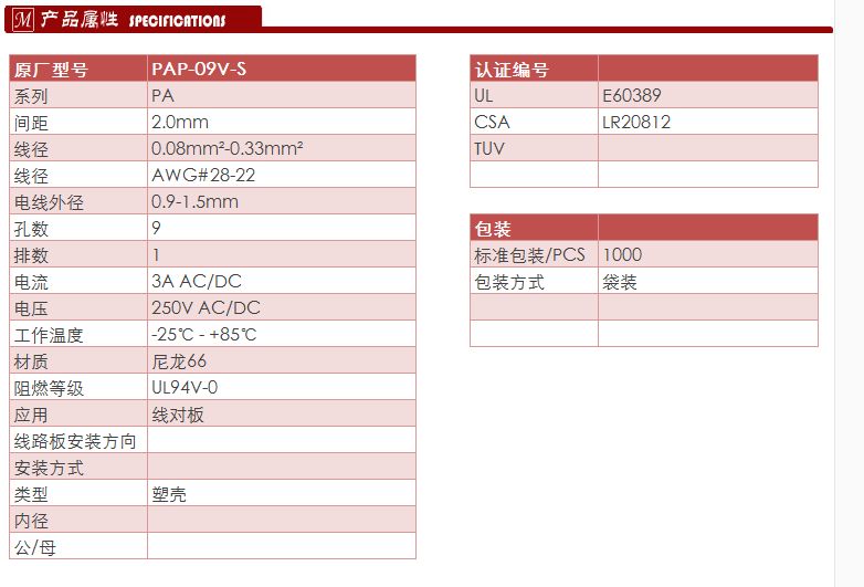

Postby ex-Gooserider » 27 Dec 2016, 00:54
JST stands for "Japan Solderless Terminal" and you can find nice photos and datasheets on ALL their connectors on the JST website...
PA connectors are at http://www.jst.com/home8.html There are plenty of other sources but in the US at least, Digikey carries almost all the JST connectors in stock....
