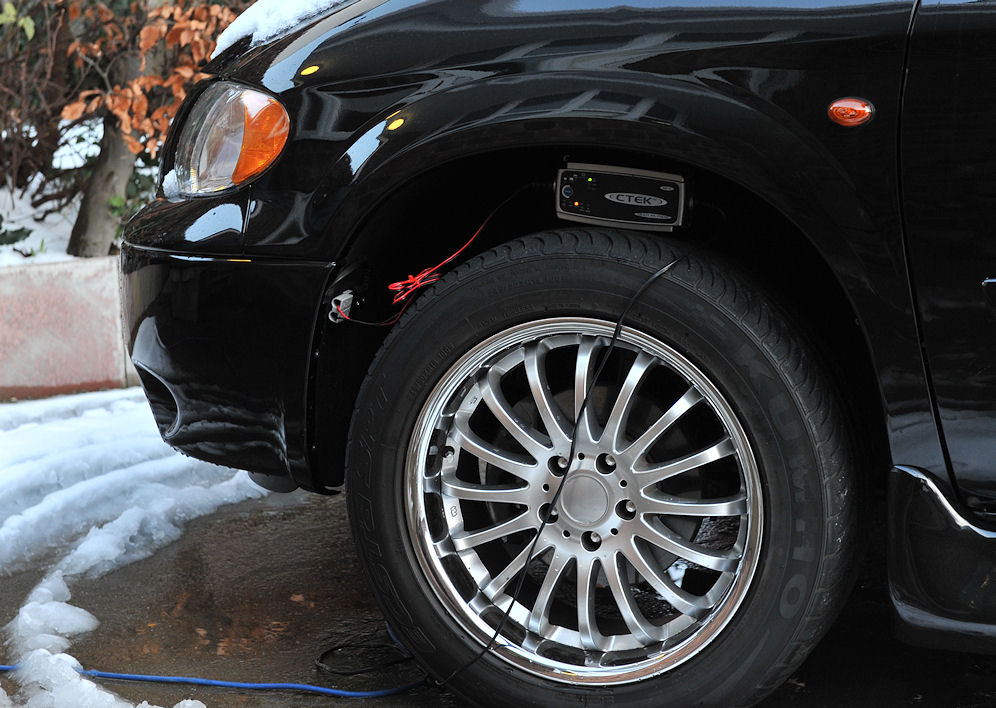

So if you leave your car or van for more than a week
its a good idea to charge it. Or more accurately to "maintain" it in a
healthy fully charged state. Your battery will stay healthy longer.
Buy a battery optimiser or battery maintainer as soon as possible if this scenario sounds like
you!
Your battery will love you and it will stay
healthy much longer. It doesn't actually need a full charge (although that wont
hurt) but it needs a maintenance charger like this Optimate at the top of the
page (or
something similar)
connecting and leaving connected while you are not regularly using your car.
It may well still start
if you don't bother but your battery is suffering and will, sooner or

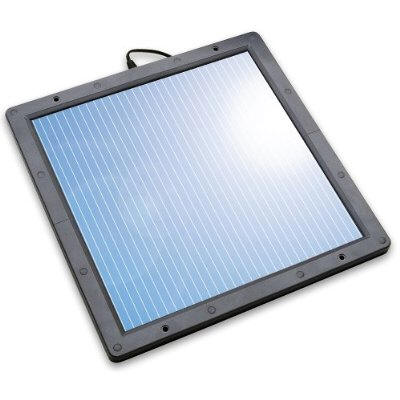

later, let you down. Another alternative is a good solar charger of 2 to 5
watts. It wont "charge" your battery but it will keep it topped up hopefully and
prevent it going flat and sulphating. Less than 2 watts is a complete waste
of time unless you live in Arizona! I leave a 5 watt one above plugged into the cigarette lighter socket
and sat on my
dashboard when I am not using my van. It keeps my battery fully charged up and
healthy if the vehicle is unused for long periods. of a week or more!

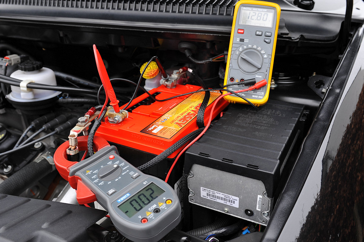

See larger image of the
Hawker Odyssey battery under test.
Here is an example:
My
Disabled adapted Rollx van. Has all kinds
of immobilisers, satellite navigation, engine management, alarm and an extra computer in the
boot to control the ramp/door/lowering etc. Here it is with the vehicle
all locked up and the engine stopped. After 30 mins. The Clamp Ammeter shows a
0.2 amp (200m/amp) drain on the battery. This is quite high but similar figures may
be typical for some other modified
vehicles of this kind. 20 to 50 m/amp is more normal.
It initially starts as 10 amps plus after switching off getting
out and locking the van! 10 Amps! But gradually all the various electronics go to
"sleep" and it settles at this relatively low value. The voltmeter shows the
brand new Hawker Odyssey battery is fully charged at 12.8v. Now 200ma at
12v is 2.4 watts. Or about 0.2 amps lost per hour while parked or 4.8 amps per
day. This looks abnormally high but it always seems to settle at that figure.
50ma is probably closer for most vehicles.
That means that in ten days time if I don't drive it or charge
it the battery will be 2/3rds drained! that's right 2/3rds!!! It will have
suffered some sulphation and had its service life shortened. It will also probably
still start the Van - Just! After two weeks? Doubtful if it would.
