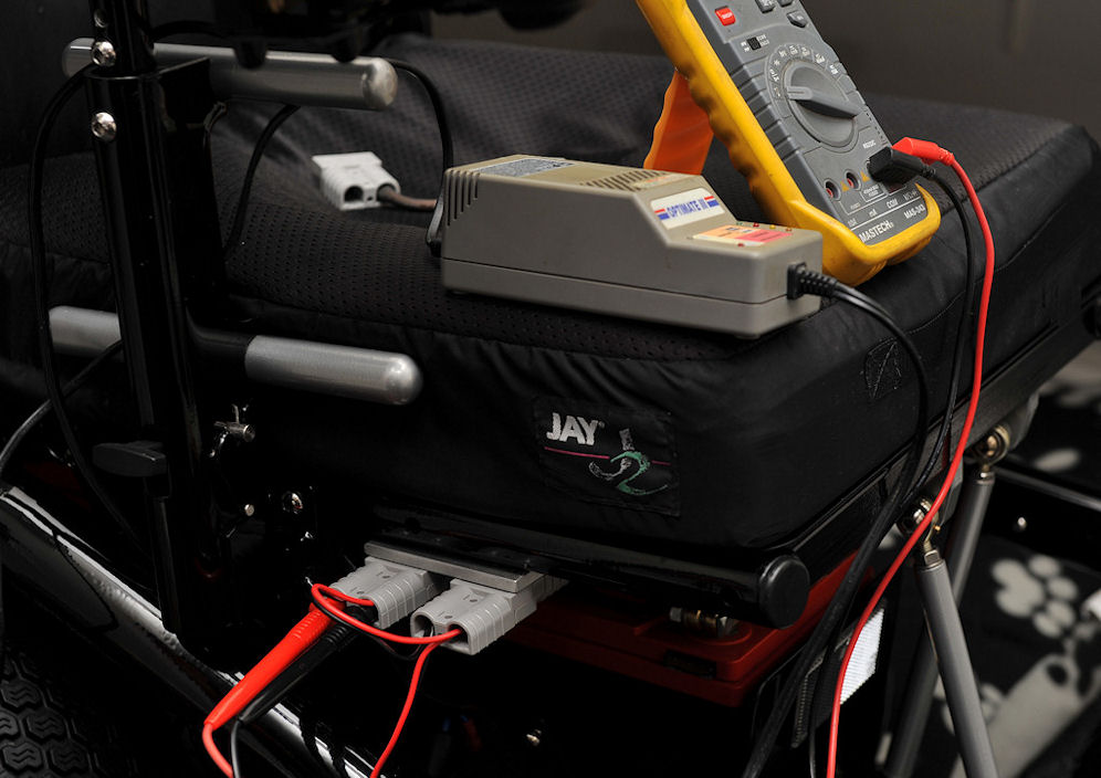

The above advice is very generalised. Not all chargers or
batteries are the same. In an ideal world you would need a maintenance charger
that holds your batteries at the perfect voltage for long term storage.

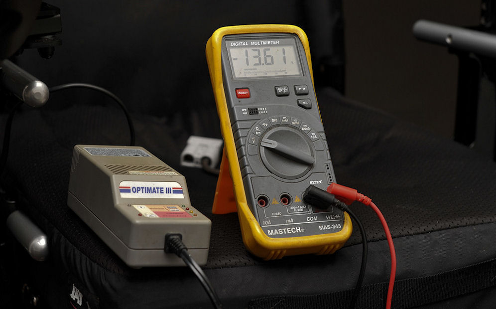

Some mobility chargers do just this! But they don't tell you
that they are doing so. So only a voltmeter and some skill will let you really
know. Some just charge until "done" and stop completely. Again only a Volt meter
can tell you what is actually happening.
The correct storage voltage (Float voltage) the case of a
typical Gel battery would be approx 13.5 Volts per battery (so 27.00v for a
typical powerchair).
Or in the case of an AGM battery which are becoming more
popular in mobility devices then 13.25v (26.5v) is best for long term storage.
Suitable
low power maintenance chargers are available from various places. If you value
your batteries these are a better bet than charging it every coupe of weeks with
your mobility charger and will make your expensive batteries last longer in
storage.
