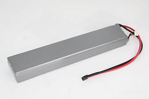

LiPo batteries While its relatively easy and
cheap to get hold of very powerful Lithium Polymer
(LiPo type) lithium batteries as used in model aircraft, and model
helicopters these are sadly unsuitable for our usage for several reasons.
To begin with they are easily punctured, which causes them to
smoke and burn... As does charging any one of the 7 individual cells above
4.200v.
These LiPo batteries are cheap, this is a 10Ah one. It is
"35C" meaning it can have 35 times its capacity drawn from it in Amps. So it can
produce 350 Amps if a thicker cable was used! It can start your car. And
its barely bigger than a coke cola can. To replace a pair of 50Ah lead acid
batteries in your powerchair would require 10 of these connected in parallel to
provide the same range. But that would take up 1/3rd of the space! And be 6
times lighter. So you really need to add 3x more capacity. So as to get an
advantage over your old lead batteries. So instead of replacing Ah with Ah you
could increase it by 3x because in the same space 150Ah will fit. And still be
much lighter.
Each one has of these has 7 cells (to give the closest match
to a pair of 12v powerchair batteries) and a 4.200v charged voltage per cell. So
it will be at 29.4v fully charged. When charging you MUST use a special charger
like this one here to
ensure that all cells are charged to the exact same voltage or a fire can easily
result!
29.4v may or may not be compatible
with your powerchairs control system. I tried it on a Pilot Plus system and it
seemed OK but don't take my word for it In any case the manufacturer will say
no! You must take the risk and test it. But since this type of lithium batteries
are very flammable and unstable they are not suitable for power wheelchair use.

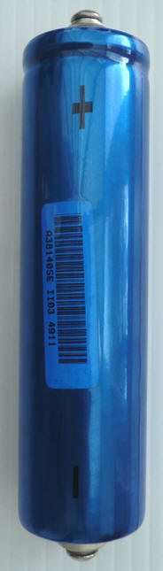

c)
Lithium Iron Phosphate OR LiFePO4 cells.
These are sold as A123, Headway, CALB etc. These are the ones we need for
powerchair use. They are available in both round tubular cells, like huge AA
batteries. or in big "prismatic" cells. Such as the CALB cells are available in
BIG Ah sizes. The cylindrical calls are available in smaller sizes. They are
easily made into packs that are the correct size for a powerchair. Using nothing
more than a spanner! These cells are SAFE. There is probably less danger than
the ones in your powerchair now.
But unlike the two lithium's above their energy density of
LiFe cells isn't quite as brilliant. It is about twice as good size for size,
weight for weight compared to your Gel batteries though!
So these are what I am using in my latest powerchair currently
under construction.
new powerchair
This will allow both 12.7 MPH and
50+Km range easily at the same time while saving 60lb of weight!
And allows for sensible off road capability and
fat high floatation tyres for ride and soft surfaces like sand.
The one opposite is 10Ah. 12Ah, and 16Ah
Headway cells are also available.
These are charged at 3.600v and 8 are needed in series to give
28.8v which is the nearest you can get to a pair of 12v power wheelchair
batteries.
And then use these sets of 8 in multiples (in parallel) to
give you your desired capacity in Ah.
Typically you will be able to get 100Ah in the space where
your 50Ah batteries were removed.
These need to be balanced when charged up. And again I will
use the excellent and cheap Hyperion charger
here |
The cell opposite is available in 40Ah up to hundreds of Ah and is completely
safe and will not burn. You would need 8x 100Ah ones to fit into the space that
your two 70Ah group 24 batteries care now for eg.
They need balance charging, and *should* work with most powerchair
controllers as used today. As long as you ignore the battery gauge which will
likely be a little confused!
