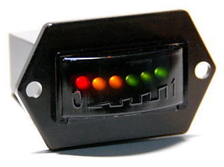

My
home built pod will also need a 36v battery "fuel gauge" from eBay...
This works with 12v, 24v, 36v, or 48v. Its programmed by the supplier to suit
your batteries. In this case Odyssey AGM batteries. See pictures under
test below!

Battery "meter" or fuel gauge arrived. On test here. This works
automatically on 12, 24, 36, or 48v
In this image it has ALL 6 Led's lit. And this is at 25.4v. Over
28.2V it decides to flash to indicate "over voltage" error. If the voltage is
reduced from here to 25.3v you lose the first light. Not suddenly, its "damped"
so as to not drop artificially under load such as when you accelerate. Works
really well!
At 23v (11.5 per battery) your battery is about as flat as you
would EVER want to go without real damage. So this gauge is perfectly calibrated
for my AGM batteries. I sent them the voltage details to program in when I
ordered this meter on eBay. Very efficient company. This meter needs only two
wires connecting. It draws so little current that it doesn't really ever need to
be turned off.
