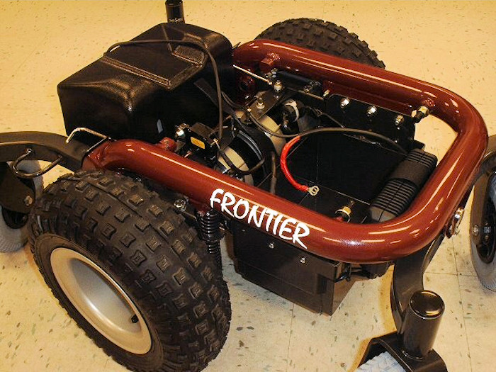

The X5 power "base" seems pretty well built and solid
however. In this image one battery is removed and you are looking at
the rear. Obviously the seat has been removed! Notice the big soft squashy
tyres. 145 / 70 - 6 rubber! There should be standard on all powerchairs. But
there is no reason for it to be 28.5 inches wide! My built in a bedroom
powerchair with the same sized tyres and batteries is 3.5 inches less wide!
Caster wheels are a little small for snow / sand etc but seem to manage mostly.
Bigger would have been better. But since there are so many of them they would
hit everything around you indoors.
