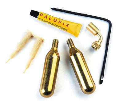

In addition you can keep a tiny CO2 tubeless repair kit somewhere (opposite) on
your chair (I don't bother). Tubeless tyres don't puncture and go down instantly
they just get a nail in them and you ignore it until you are home. And the
sealer works great on tubeless tyres even if you do pull that nail out.
So in the highly unlikely event that someone drills a hole in your tyre while
you sleep (not much else can puncture these Kevlar protected ones) you can fix
it without even removing the tyre... Takes about one minute and off you go!
