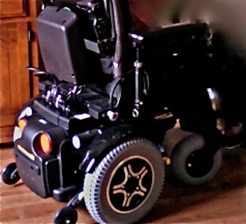

Back to this chair, I have personally only tried one variation
of the R4000 chair. recommended to me by the dealer because it had the best "torque" or power
level of the various packages. And that person knows what I like! It was the 4 Pole, 6mph version, with
although with the standard 70
amp control system. (A 100 amp version is also available too at extra cost and
is well worth paying) |

The 4 pole 6 mph version SHOULD be the most "powerful"
(best torque) for heavy users apart from the unbearably slow 4.5 mph
Hammer motor version and yet
it still struggles to climb the ramp into my van or over the small step (threshold)
into the local pub! At least from a standstill. And while still having some positive steering control. It makes accurate
entry to the pub or my van very difficult
and unpredictable & results in lots of extra dents and scratches and
battered fingers compared to real control I have with my existing powerchair.
That would be
rectified HOPEFULLY with the optional 100 Amp controller option (rather than the
70 amp stock) that this chair had. As long as it was correctly programmed though.
Stock programming is awful. Even worse than most...

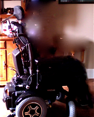

It is a little wider and longer than it really needed to be.
That is its Longer and Wider than my
own powerchairs which is crazy
since they also have huge fat easy riding comfortable (outdoors) tyres with some
off road beach/sand capability too. The Quantum chairs
Athena / R4000 / R4400
should & could be narrower than mine! And shorter. Every inch or part of an inch
really matters indoors and in confined spaces like vans
/ loos, homes / restaurants etc.
It has the usual "hit every door frame" swing away footrests.
Although a single central platform may be an option (check if available as it
probably is as prides options are very involved and comprehensive) and it
looks a lot "nose heavy". Don't
worry sir, unless you make some modifications to move the seat back they are all like that as the
manufacturers are scared to death someone will tip out of the back on steep upward

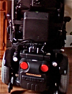

The only fly in the ointment really is that from the rear (or
the rear quarter) it is plain pig ugly!
With a great big battery box sticking out of the
rear like its taking a dump. This alone would probably stop me buying one.
Why do manufacturers not "get" this
aesthetics thing?
Who wants to drive about looking like the battery (or
worse) is hanging
out the back?
Plus it gets in the way as you reverse in some situations indoors
(hits my bed when reversing from my computer) along with the oversized anti
tip wheels that are too near the outside edge, forming "corners", too
low, and too long.

(225mm). If we allow 4 inches of ground clearance
(like my own chair has). 1/8th inch for the battery floor material. 1 inch clearance between
the top of these batteries and the seat frame we get 15.5 inches.
The seat on my
Group 24 Powered Powerchair CAN be set at 16 inches with the stock seating. If I
made a slimmer seat base I could reduce that by another inch... Although I set
it at 18 since I have long legs...
So I have almost double the ground
clearance of this Pride Powerchair. And that's WITH some big fat tyres with lots of floatation so
I don't sink in snow or sand either... And its still narrower too!

Ugly Bum... I have never seen so much "designed by committee" mess on one
rear end! Just look at it. They never heard of "clean lines" or finish. Looks
like a ships boiler room. A mass of pipes, wires, plastic boxes, and the worst bit, a huge battery
box sticking out of the back! Some of this "ugly" is caused by the "rehab"
multi adjustable seat, which means the batteries are smaller (lower) and the seat higher
still, But you get this battery box sticking out in the way regardless. Be careful what you order! >>>
Compare this "nose heavy" side view with battery box hanging out to my own chair
here to see what's really
possible with the same sized batteries.
Why do you suppose there
isn't a single picture of its rear in any brochures? (or the web)
These are thanks to a reader!
